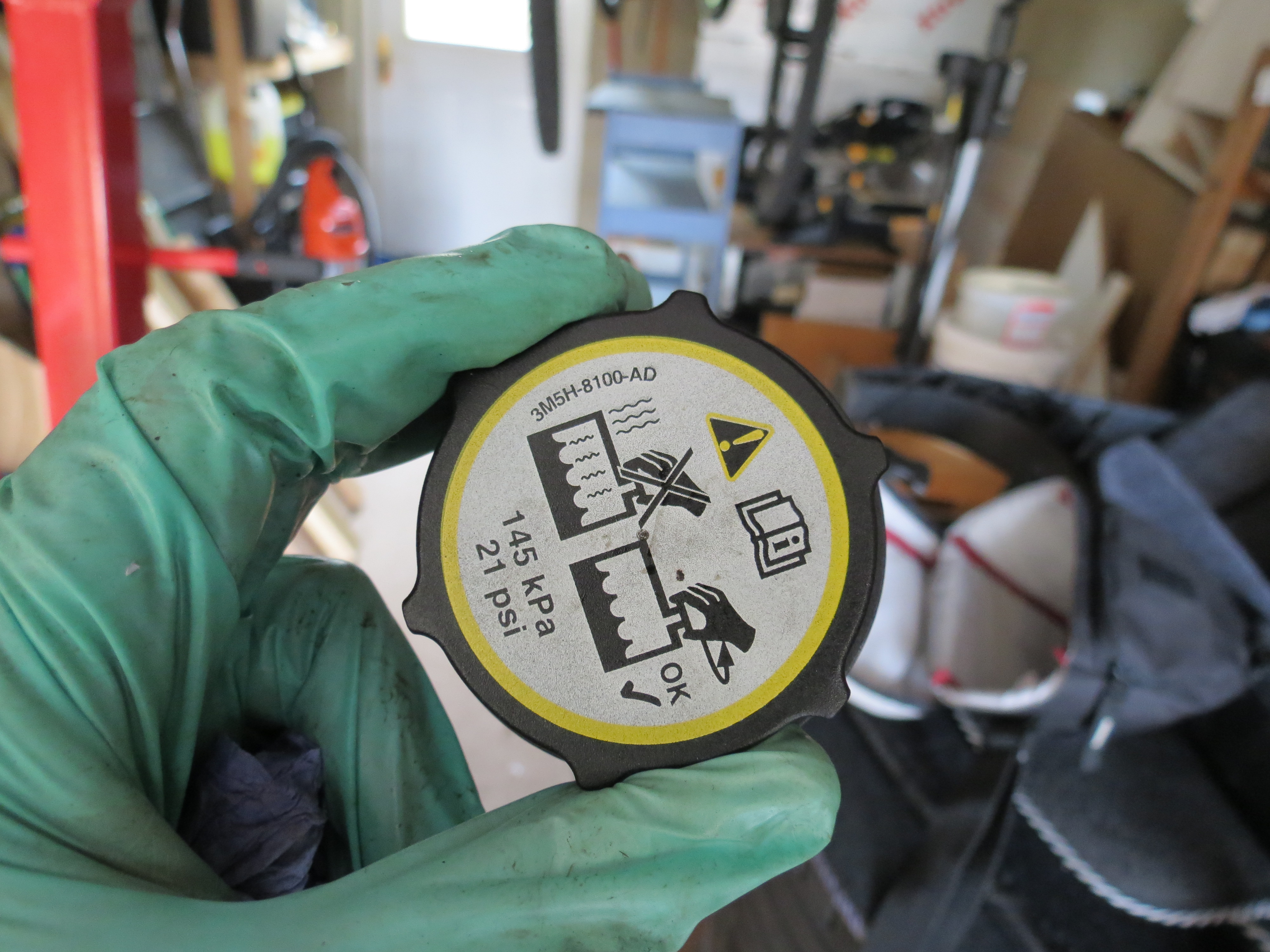

Has anyone found there expansion bottle cap to be tight, I mean *really* tight? First time I noticed it I just about got it undone with my hands but I was very close to resort to tools. Since then I've had to give it a lot of grunt again to the extent that today the cap came off in my hands but the pressure-sealing body remained in the tank!
I got the body out with adjustable pliers but I can see this happening again if I don't do something about it. It seems a widely available part, copies of which are also produced by many other manufacturers, and so it made me wonder given such availability whether they are a regularly needed item so thought I'd ask here. (Edit: I've seen an application list and there are hundreds of Fords and Volvos on it so perhaps that's why there's such a market for them!)
I am assuming it's the cap (and not the bottle) at fault and that perhaps one of the o-rings has swollen somewhat hence why it is remaining so tightly wedged in? There were no other obvious indications as to what it might be.

Thinking about this I don't imagine that the o-rings in the cap get much of anything in contact with them in normal use. The tank seems to be heavily baffled so there's likely not going to be much sloshing around so I think perhaps the o-rings (the bottom one at least) is possibly drying out,  hardening and expanding slightly in the process? I may try a smear of silicone grease on the new one and, as you have been doing Dez, undoing to periodically to keep things moving.
This has been posted before, apparently it's a common problem. Ford service use silicon grease on the threads.
The O rings do in fact dry out & swell jamming the cap solid, common fault on every ford going which has the same cap.
You'll need a new cap & silicone grease.

Get some silicone grease and remove the O rings, give em a good coating then put the rings back on, then grease the inside of the plastic tank.
Since mine jammed I've been removing and checking my cap once a fortnight, re-greasing on every check... just don't want that to happen again.

Purchased new cap, top of the cap came off which left a lower part stuck in, drilled an X shape into the plastic until it fell to bits, cleaned everything up, greased the rubber seals and fitted new cap = £12..... Hate to think how much the dealership would have charged me if i'd taken their route & advice :sad:
