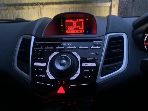

Hi, I just bought a 2009 Fiesta Zetec S, so it’s the MK7. I was wondering if anybody knew if the Sony stereo with the new screen (the blue one) was compatible with it? Thanks

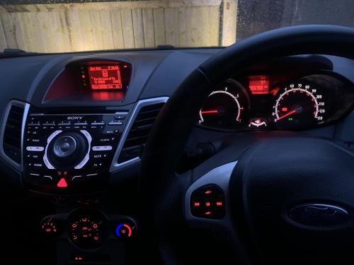

I have a 2011 Zetec S and just swapped over the stereo fasica to the Sony one, i think it looks better with the orange screen that matches the orange guage cluster screen, have attached pics
Chris

If you find a Sony unit from a pre-facelift then it should just be plug and play. The facelift ones, despite looking the same, are completely different inside.

Hi, my stereo already had bluetooth streaming and phone, changing the fascia just changes the look, does not add any functionality
Chris
