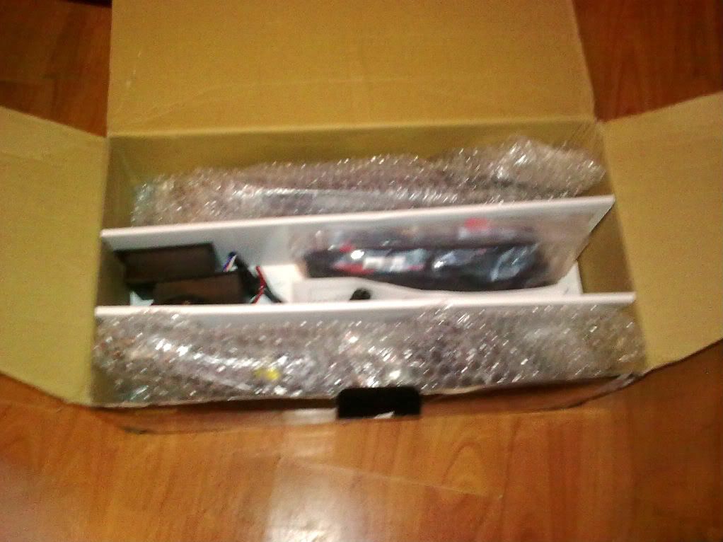

Just recieved my set of DRL's in the post today from Taiwan
purchased them through ebay from this seller
cost me £98.98 http://www.ebay.co.uk/itm/220963630409?ru=http%3A%2F%2Fwww.ebay.co.uk%3A80%2Fsch%2Fi.html%3F_from%3DR40%26_trksid%3Dm570.l1313%26_nkw%3D220963630409%26_sacat%3DSee-All-Categories%26_fvi%3D1&_rdc=1
supplied with tracking number on dispatch from Taiwan took 7 working days to get here in ireland and luckily no import tax may be due to the seller included an invoice for Mini Cooper Replacement Wheel centre cap Cover Kit and valued them at $12.00
no dash switch supplied though, so im a bit disapointed about that, but the drls are quality,
roll on to this weekend and i can get them fitted B)
They look the same as mine Lenny , have you checked if they they have the extra wire for indicator dimming? , if not then they are the same as mine :)
