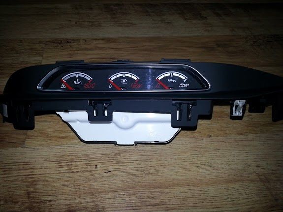

Purchased a MK3 Turbo Pod , and yes i know the chance's of getting it working will be on the Minus scale , but for what i paid , i'm at least going to research and try :)
Is there anyone out there with a Mk 3 ST will to take a picture of the wiring for me :) ?

  • It's going to be a long battle i can tell haha Anyway Pod has arrived , minus the top section <_< , which i figured as much as the picture's never showed it , but it was a good buy. So off
  • Update* Boost pod arrived , i thought it was just the lid , but it was the whole part , but without the actual gauges , which save's me having to glue the lid on. So here is my idea , i will need a
So off to Ford and ordered the top section £58 for the £1.50 bit of plastic trim , rip off merchants lol.
I will have that by next friday as it has to come from Germany.
I tried the Pod in place , and i will have to cut away small sections where the speak cover clips in , not a problem. i will either have to move the centre speaker or leave it out as the dash pod only has a small place for a tweeter.
So for now i will test the Pod wiring connections to see if i can get it to light up at least while i search for any wiring diagrams for the ST which are like Hens teeth.
If that fails completly then at least i still will have the Pod for which a Scan gauge should fit in or some 35mm guage's perhaps , so not all is lost.
I have also thought of :P ,an Android phone loaded with torque pro and sit that inside the gauge. So even if i can't get it working as is , then at least i can investigate other possiblilties. :D
So here is my idea , i will need a 6" android tablet/phone , this will then fit into the viewable area of the pod , then set this to the gauges i want to have on to the top of the screen , i have set my phone up to demo this , using sleep mode and the screen set to POWER on via charging i can turn this on/off via ignition and not have to retro fit any buttons , i have limited control via the screen to move stuff about , but i can set any number of screens and then scroll through a selection of what i want to see.
I think this idea will keep me going until/if i can find a way to actually fit the gauges inside and have them working , i can fit the gauges in there already and light them up , but then its just for show!.
