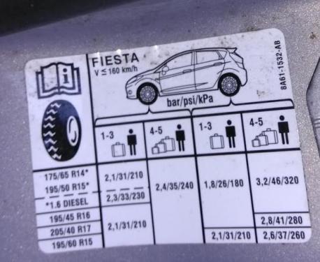

On the passenger door well it say 33 for carrying 2 passengers. So I have put 33 in all round is this safe and why do websites dish out wrong/dangerous information?

Just spoke with Kwik Fit and they say always go with the info on the sticker on the car door-well. It says 33 so that must be right? I am still unsure so I will check the manual also.

I will stick with what the car door well sticker says for 195/45R 16 1.6 Diesel.

That's a pretty poorly designed sticker tbh!
The 1.6 Diesel there is only relating to the 14 or 15" wheels above it (note the asterisk).  195/45/16 is 31 front & 26 rear for normal load on the sticker.  But that's even different to the handbook which suggests33psi front! :laugh:
