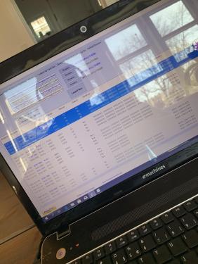

i have gathered a couple of vins from cars with the led option, and will have to analyse the A’s-built data, and hopefully find the right hex to make it work
I have started the process of figuring out what codes need to be change to make the headlights work, and if it is possible. I would greatly appreciate is some of you who were lucky enough to get the led headlights would share your vin. The more data I get, the easier I can figure out if this conversion can be done
