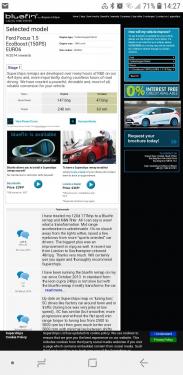

2041082487_Screenshot_20190424-142726_SamsungInternet.thumb.jpg.dbb815f146707bde88c0d7b94041f14a.jpg
https://www.mybluefin.co.uk
Just do it yourself via a Bluefin handset and get a nice 194bhp.

Thanks for the information.
Probably something to consider when out of warrantee.
Looks doable but wouldn’t want to risk on a vehicle only a few months old.
That looks like it's for the 4-cyl 1.5 in the Mk 3.5?
