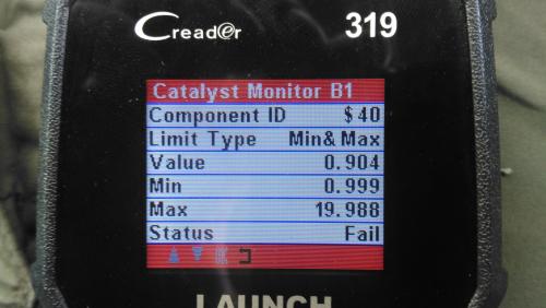

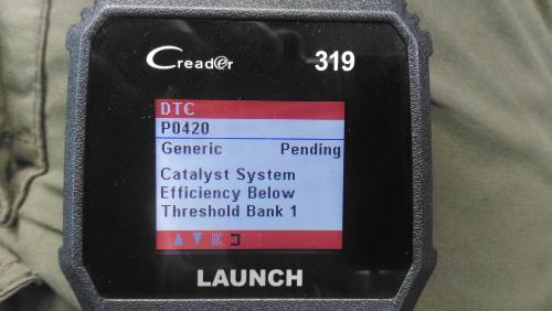

I've already swapped the old harness with this new harness and been for a test run.  The engine runs almost fine but I can tell its still running a bit lumpy, I'm also getting some different data from the OBD2 scanner regarding the cat:
Perhaps a result of the injector fault?  May have chogged the cat up with rich/un-burnt fuel?
So what I'm thinking now is that maybe I've finally fixed the P020 fault and that the previous misfiring has flooded the cat causing another fault lol.
As an update - no more problems up to this point so the misfiring must have been caused by the injector harness.
The next time I filled up with petrol I stuck Esso supreme + in it and basically gave the engine an Italian tune up for a few days, that seems to have cured the blocked cat for now because there are no more cat codes and the cat is a pass according to OBD data.  Although I expect the cat is the original and the car has passed 56k so it will probably need changing in the near future anyway.  Engine is running great now so will be filling up with top tier fuel from now on.
