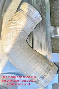

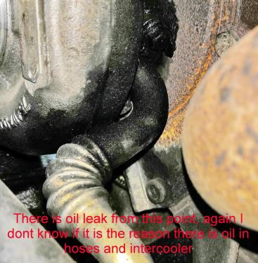

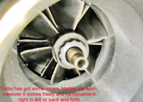

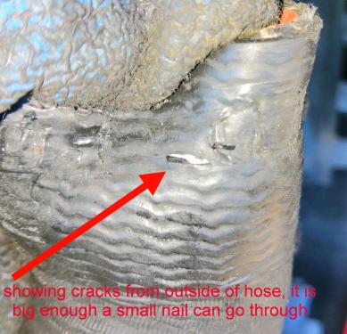

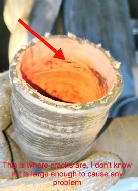

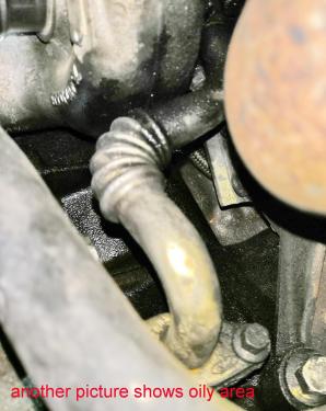

Today first time I have gone further to remove every hoses connected to Turbocharger and intercooler, I have included pictures of what I have found out
Any suggestions,any advises, anything will be very nice of you, please come forward to tell whatever you may think it will help me, I will come back once I do more to solve this problem out

The 90 degree shaped hose is a known failure point on this engine (one of it's few weaknesses) most of us on here that have experienced the issue replaced it with a silicone part that will last longer than the car and only cost a few quid on ebay compared to the £40 Ford want for a rubber hose that will eventually go brittle again.
