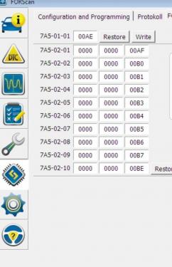

I have just had my 2012 (Sync1) Focus 1.6TDCI  fitted with a rear view parking camera and all wiring installed. The technician who did this upgrade is pulling his hair out because he has tried all sorts to get the camera working. It now appears that I need an adapter because my 5" screen is of an older version. Without  this adapter it appears that the required fields in Forscan cannot be updated.

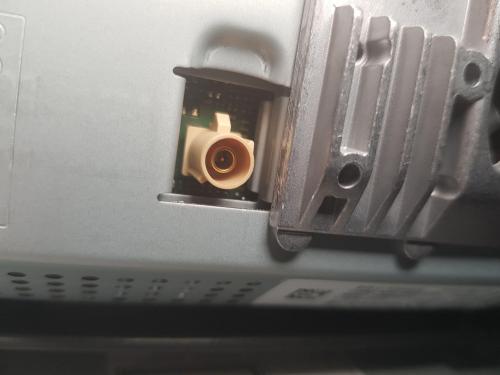

Another option is to install a newer version of the 5 Inch FCDIM which no longer requires a rear view camera module. These displays can be identified by the Rosenberger/Fakra HSD connector at the back and accept the video feed of any NTSC rear view camera.

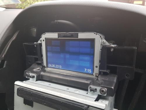

Seems like I'm snookered!! here's a few pictures of what I have, Evidently I don't have Sync at all on my 2012 Ford Focus!! I have Bluetooth with Voice and Active Park Assist and Sat Nav instead.
JW, do you have a part Number for the replacement 5" screen. If I do buy one I want to ensure I have the correct one.
