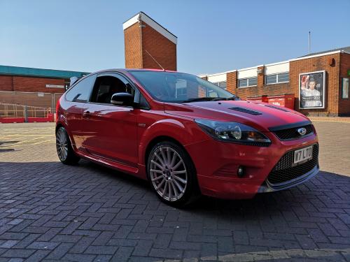

This is my mk2 lowered on eibach 40mm
If you want just to line up with the arches then 20mm if you want an even wider look then 25mm. There is plenty "hub centric" spacers available on eBay or there is more expensive versions like eibach or hnr. Make sure you get hub centric to be safe.

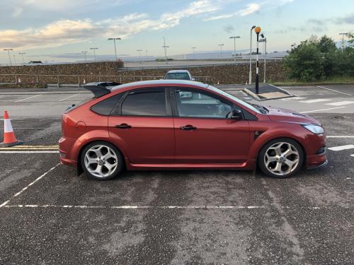

Don't know if mine is lowered, but I know it's got the Ford coil springs with the coloured bands on them.
Defo looks lower than mines at the rear.

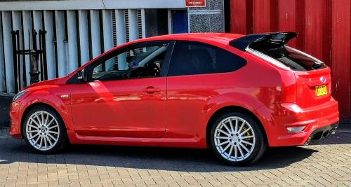

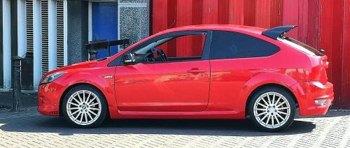

this is mine, a twin almost of Wilto's motor... and she has a front number plate i just chose to black it out for the pic.

Nice only difference is wiltos is a facelift MK2.
Ok you want to lower the rear more and you are on coilovers so you need to check that the rear adjust nut is wound all the way I don't think it will be if you have a big difference between the font and rear this is where you need to get a pic
If it is the only other thing you can do is remove the adjustment nut to lower more there's no spacers that you can install to lower the rear of the car
If that doesn't work you can chop a coil off the springs lots of people do it to level out the rear suspension
If you have spacers fit them and it will make the rear look better as the gap will look smaller also have you tinted your front windscreen looks very dark ?

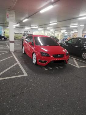

Quick pic of my front end
40 mm H&R
