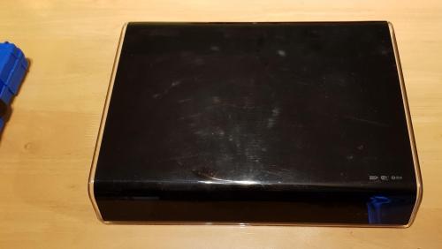

I have this Cisco 8685 HD viewing box which Virgin Media Ireland use for a multiroom box.
I have three of these units in total;
Apart from the unit being the size of a DVD player from the mid 90's

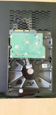

The other issue i have with it is; the noise of the 3.5" hard drive rotating as this viewing box is fitted in the bedroom.
Overall: I'm looking to upgrade the hard drive in my Cisco branded Virgin Media multiroom box to a solid state hard drive;
I'd like some advice on what's the best like for like option while eliminating the noise of the massive 3.5" HDD as theres no information on doing this process to a VM Cisco box anywhere else online 🤷‍♂️

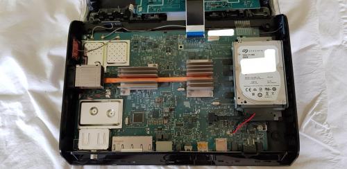

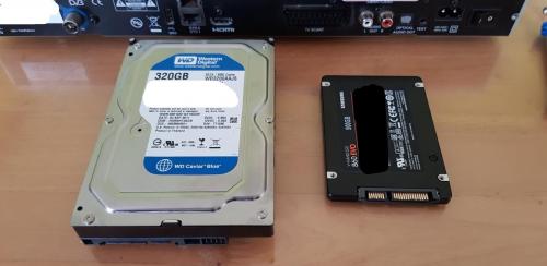

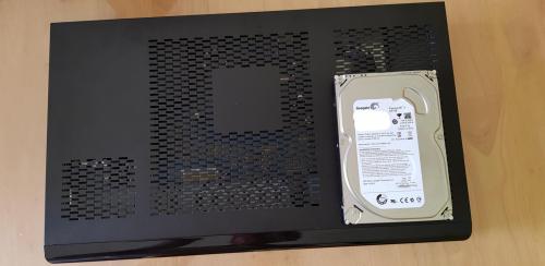

Here it is positioned next to the old 2.5" hard drive from the Playstation 4 its massive in comparison.

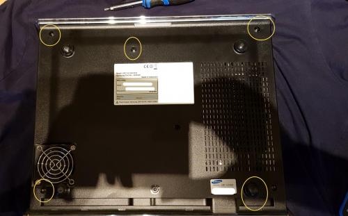

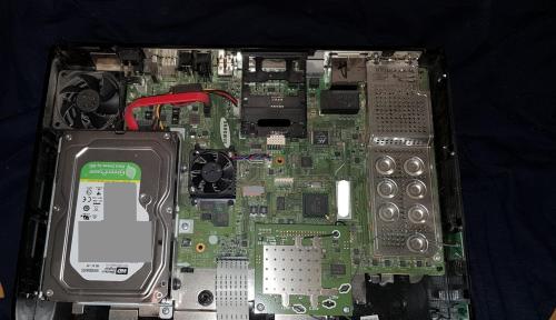

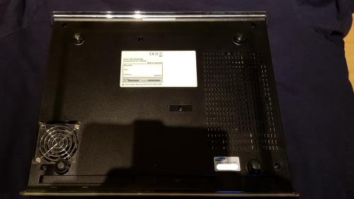

But the living room box is a Samsung SMT-G7401/XEN it doesn't have a solid state hard drive neither, it has a thermostatic cooling fan but still gets quite hot.

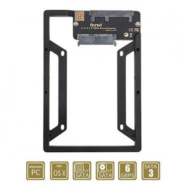

The only item I've purchased to date was this neat 2.5" to 3.5" metal adaptor frame
which is minimal design compared to most other 2.5-3.5" adapters available on the market;
Being minimal is design; it will help keep things as cool as possible while also allowing me to secure the new hard drive in to the same holes as the standard one..

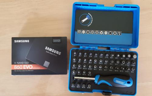

I logged on to Amazon last Thursday and purchased a 500GB Samsung 860 Evo Solid State HardDrive which arrived to me in Ireland thismorning 🙆‍♂️

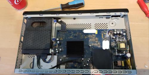

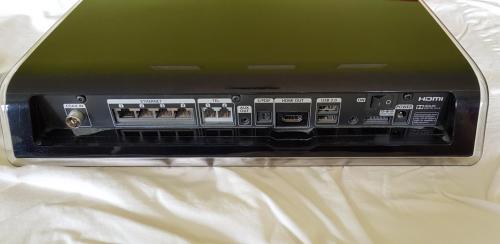

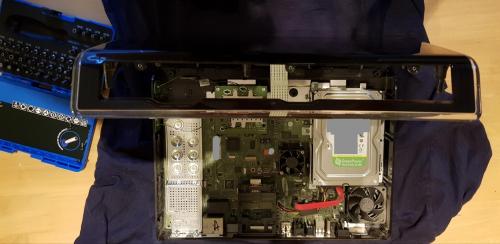

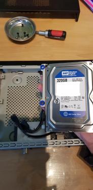

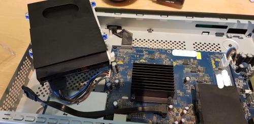

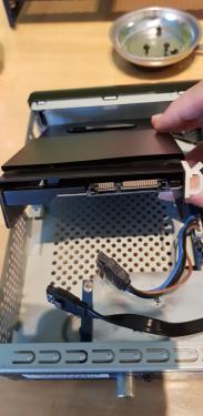

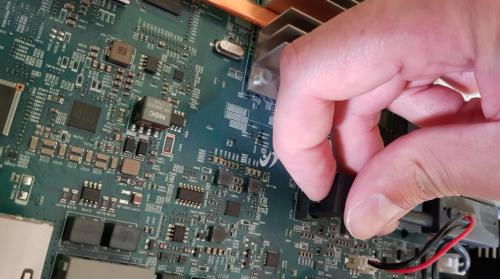

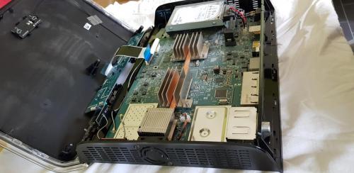

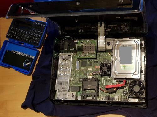

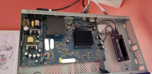

The above image shows the amount of empty space inside the multiroom viewing box; the motherboards could have been double stacked including the HardDrive to half the entire size.

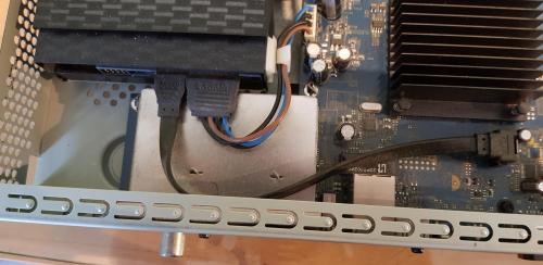

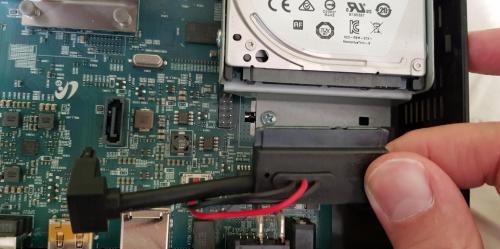

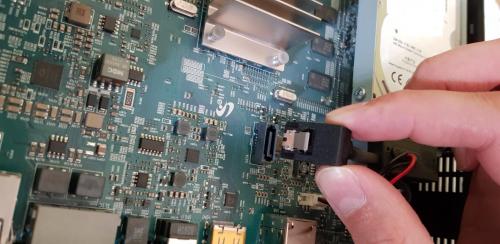

The above image shows the SATA cable; I ordered a SATA3 from Amazon but this one fitted says ASAP on it;
I googled and found that SATA3 and ASAP are exactly the same thing both capable of up to 6GB transfer rate with the ASAP standing for "As Soon As Possible" ☺️
So I've left the SATA3 cable untouched,

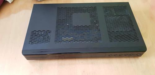

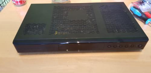

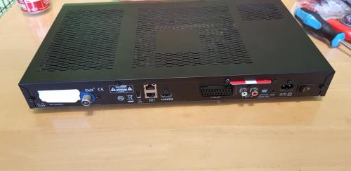

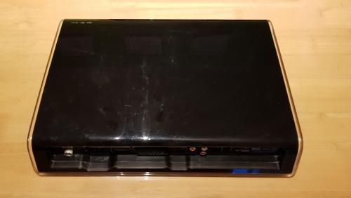

The Cisco box which I took apart for upgrade was an old box which I had spare since I cancelled my subscription and signed the wife up instead in order to avail of a 12 months half price subscription deal 😉
The only sting in the tail was now; when I fitted the SSHD and tried to power up the old Cisco box; it wouldn't function only to display a screen image request for me to call Virgin Media and register the box to the subscription service.😟
I then tried inserting the viewing Card which was registered for subscription; tried inserting that in to the old viewing box; however it then asked me to insert the correct card for the box🙁

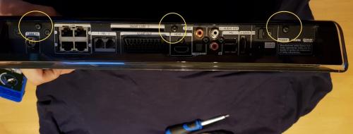

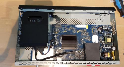

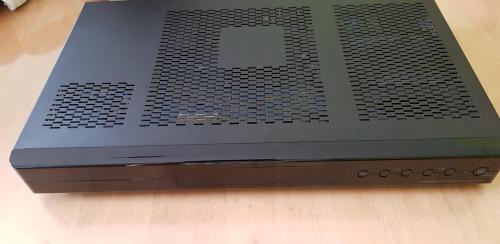

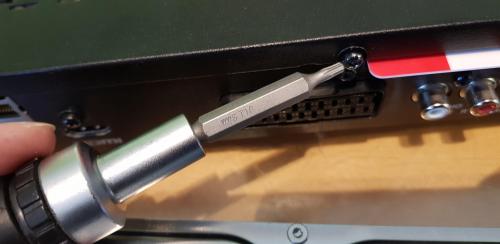

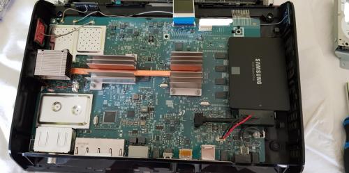

At this point I then had to open another Cisco box identical to the first unit but this one was registered to operate with the existing subscription and card👇
WWS T10 Torx just barely managed to remove the security screws successfully alternatively I could have gripped there mushroom heads with a pliers ☺️ there not very secure atall.
Four Torx screws removed and were successfully in 🙇‍♂️
Interesting to see the lack of consistency or loyalty with the supplier as this box had a 320GB Western Digital HDD where the previous box had a 320GB Seagate HDD both viewing box are exactly one year apart in production.

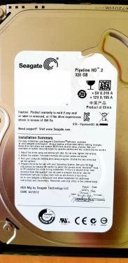

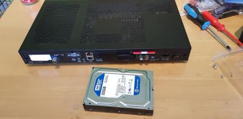

Anyway; above image is the 320GB HDD set next to its replacement 500GB Solid State HardDrive, huge difference in both the size and the weight.

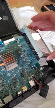

I plugged the SSHD in to this account registered VM box to trial before fitting 100% of the way just to test if it was going to be a success before completing the process 😬
A few butt clenching minutes later and Thankfully it was a sucess;
The unit started up without a single sound and continued to function without detecting anything different atall it seems the Virgin Media software program is stored on one of the boards while the HDD just stores the viewing/Recordings;

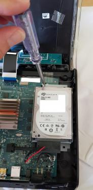

So I unplugged the box again and set about fully installing the SSHD.

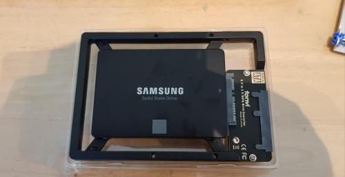

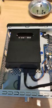

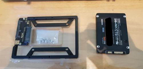

Above is the SATA3 2.5" to 3.5" adapter which I've linked to before; I quite like its minimalistic design its also very strong &sturdy no flexing atall,

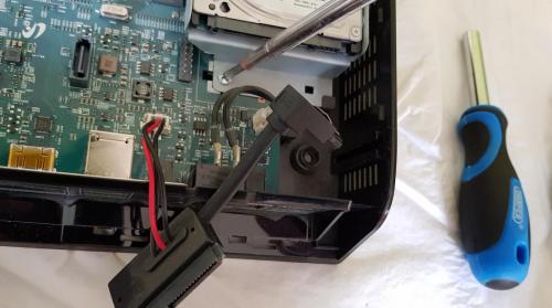

Fitted the original brackets to both sides of the 3.5" adapter where you can also see some blue rubber grommets were fitted to help reduce vibration from the original noisy 3.5" HDD.
🤔 I tried fitting and suddenly the cables weren't long enough 😅 I then realized; I had fitted the replacement drive upside down 🤦‍♂️
I removed the four screws; turned the drive upside down and refitted the four screws securing the side brackets;

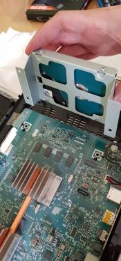

The cables are now refitted exactly as they were in the original drive,

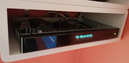

One final picture then of the viewing  box internal setup with the replacement Solid State HardDrive fitted before refitting the cover and the four Torx Screws👍
Refitted in the bedroom now and its operating perfectly without making any noise atall doesnt create half as much heat and theres an increase in the storage capacity;

Here is the first generation Samsung Horizon box model SMT-G7400/XEN which I have opened only to compare its internal with the newer model, and show how the lid is removed,
Some front & rear pictures

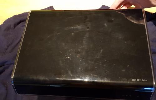

I've placed the unit upside down on a piece of clothing to prevent scratches;
Using a T10 Security Torx bit; removed the five screws from the underside
Followed by removing these three screws from the rear,
The top then clips off; but take care when lifting as there are still some cables attached to the lid.
In the image below; you can see why this generation of viewing box is considerably noisy as it has two internal fans and a 7500RPM 3.5" HardDrive 🛫
I've positioned the lid much like a car bonnet to best protect the cables attached from damage.
Now moving on to the new updated Model SMT-G7401/XEN
We discovered that the newer model is quieter more silent in operation due to it only having a radiator and one thermo static cooling fan aswell as a smaller 2.5" HardDrive although these units still make noise, the newer generation of Samsung Horizon box is considerably quieter in operation.
I've gotten the same 500GB Samsung SSD as used in the multiroom box and my PS4
I also thought I'd be a bit more professional about things and picked up a Draper 82399 security Torx set from Amazon for ten pounds link: https://www.amazon.co.uk/dp/B01GZWT5FW?psc=1&ref=ppx_pop_dt_b_product_details

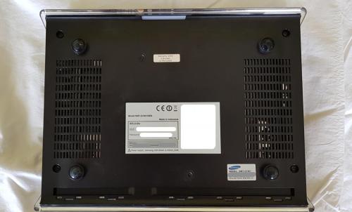

Now heres the new box

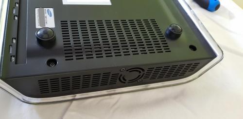

First impression of the underside shows a security seal covering the centre screw where the first generation hasn't gotten any security seal atall,
The second fan underneath doesn't exist on the second generation neither,
The side fan still remains yet it is the only fan present on the entire unit.
Theres no longer a viewing Card slot fitted to the box; it doesn't use a viewing Card atall,
The method for opening up the unit is identical to the first generation model; the only difference is removing a warranty seal to access the centre T10 Secure Torx
And here we are inside; you can see a newer laptop style 2.5" HardDrive, also theres a new radiator system setup spanning across the motherboard using only one fan which personally I think it looks impressive.
Below you can see thr side fan and how its linked to the new radiator setup,
Unscrewed the top bracket of the HardDrive
Unplugged the SATA or ASAP as it's called here meaning "As Soon As Possible" connector
Gently press on the clip and unplug
Followed by unplugging the opposite end from the HardDrive in order to gain access to the second hard drive bracket.
Unscrewed the bracket
And out comes the hard drive
i then plugged in the replacement SSHD
I just plugged in the SSHD momentarily; without fitting the HardDrive bracket in order to find out whether the system would operate smoothly before fully fitting the replacement drive.
So I reconnected the box to the television and power supply; turned it on,
The system started up as normal but then shut down again after running the initial startup process it would return to standby mode.
