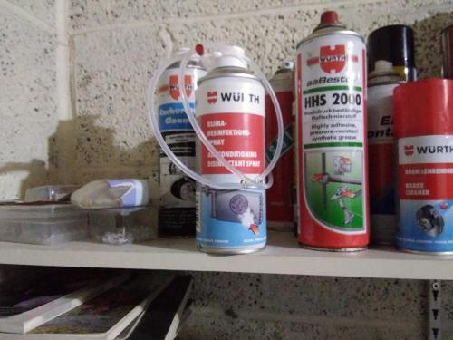

Wurth air con cleaner. Comes with a long tube and spray nozzle. You put tube up the Aircon drain pipe so the cleaner actually sprays in the area of evaporator. Half a can more than enough .
Sweet, thank you!
Do you know where abouts the drain pipe might be on the MK8?
No, I don't unfortunately. If you can't find the drain, I would remove the pollen filter and blast it in that way
Well , the air con condensation water drips out underneath on the n/s over a heatsheild . So my guess is n/s inside car behind this panel where you might find pipe
