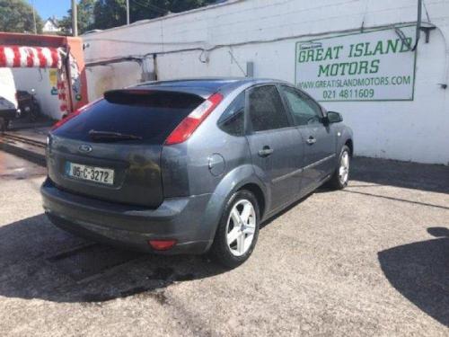

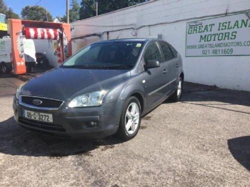

Pre-facelift model:

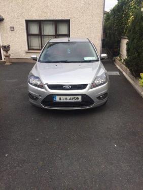

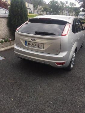

Facelift model:

The chassis on both models is identical; only the body panels and front sub frame panel are different.
