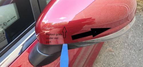

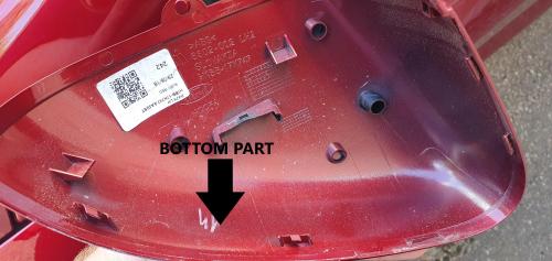

Just changed side signal bulbs to led.
Blue is prytool and picture shows where to start.
Just press black bottom part 1-2mm down/ in so you can slide prytool under red part.
Then slide it gently to right until you hear a click.  I was struggling with this myself and tried to take off mirror lens etc..
So no need to touch the mirror at all.
Now its easy when I figured it out!
Then slide gently to right until you hear a click.  I was struggling with this myself and tried to take off mirror lens etc..

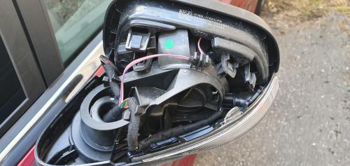

You are an absolute star mate. Just done it and fitted the new lens. There does appear to be clips at the top however with the cover removed I poked a tool through the top of the mirror and it isn't easy to get on to them. Your way is much easier. Many thanks
