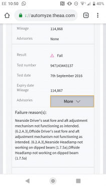

My car failed mot because both seats had broken handles I believe. This was before my ownership
