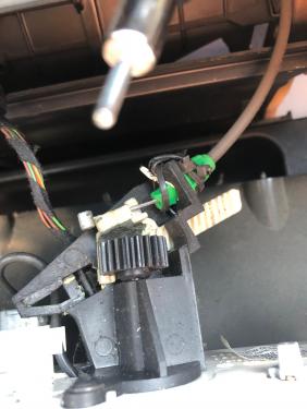

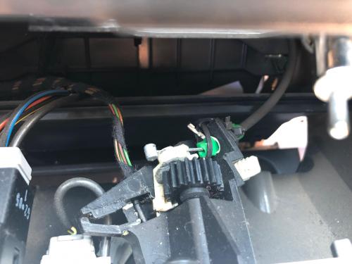

think we may have found the issue:
does anyone have a pic of what that should look like so I can attempt a fix?

Ah, that'll definitely be the issue!  I haven't got any pics of that area though unfortunately.
I found a pic when someone removed the dash, mine is fooked! Hers I mean.

All sorted, for now, not sure what caused the issue as it works fine but the additional cable ties make me suspicious! I'm sure she'll tell me if it does.
