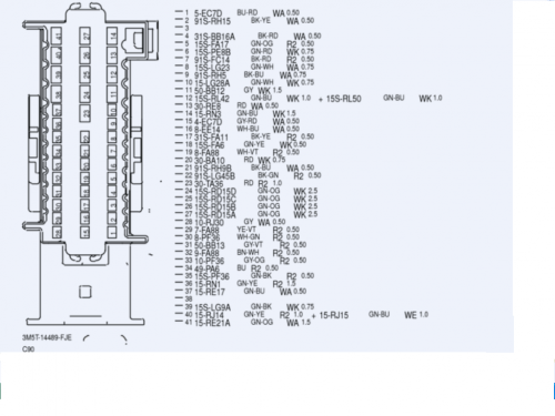

Isetta suggested doing the C90 test both ways, both from the plug and from the socket of C90 itself. One way tests continuity to the ECU, the other way tests continuity back to the IC.
I have had trouble with the original picture of C90 I posted, going all black when zoomed in. I have redone it below. Pins 1 & 15 should be the bus.
If the reading is still 120 both ways from C90 (unplugged), and yet stays 120 when C90 is plugged back in, then the conclusion I have to come to is that the wiring has been previously modified to by-pass C90, and possibly some of the other connectors (C112, C113). So removing C90 has no effect, but still one end of the bus does not have its terminating resistor.

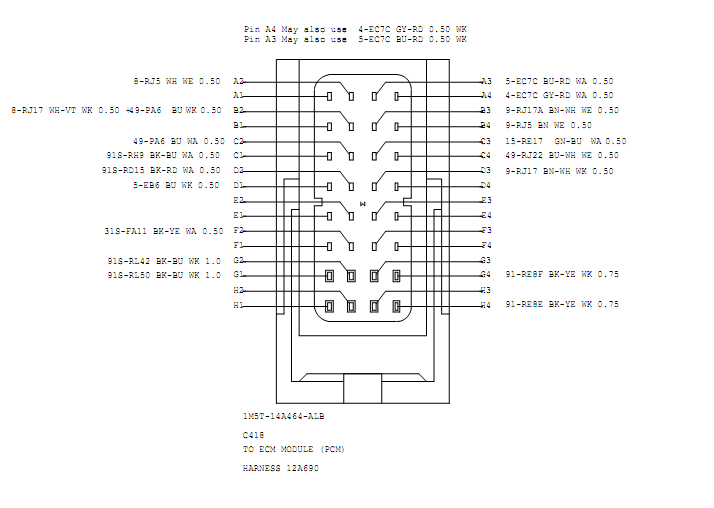

The next test is to disconnect the PCM again, I believe you have already managed to gain access. The bus is on pins A3 & A4 of the smaller of the three connectors:
Again test both ways at the pins of the ECU, into the ECU and back into the loom. If the resistance direct into the ECU at its own pins (A3, A4) is high, then I am at a loss to know how to fix this. I do not know whether it is possible to get access to the ECU pcbs. I have left mine well alone, on the "if its not broke, don't fiddle with it" principle! Some places do claim to be able to repair them, but I have heard mixed reports.

A problem I have with C90 is I can not tell either from the diagrams or from looking at my car which end goes to the PCM, and which goes to the rest of the car. There are cable looms running from both the fuse box and the cable side of C90 towards the PCM, and the actual wires are all hidden inside. As my engine is working quite well at the moment (!), and disconnecting C90 could power down the PCM and reset the KAM (learnt memory), it is not something I particularly want to do just now. But your tests suggest that the lead end of C90 goes to the PCM, which is what I would expect.
