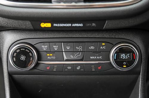

Hi guys I’ve bought a 68 plate fiesta st-line x around 2 months ago. It’s a great car but the last 2 days I noticed that I don’t seem to be able to turn the climate control off. It just blows cold air in my face non stop but if I turn it up to warm then switch it off it continues to blow cold air at my feet or windscreen. Any ideas what it might be ?

It works as it should when it’s on all the buttons work but when I turn everything off it continues to blow cold air. The way I had it set up can change where the air is getting blown tho. For example I set it to windscreen and hot air and turn it off then it blows air at my feet but if I had the windscreen with cold air on then after turning off it blows air at me. Hopefully it’s just a faulty module that can be replaced under warranty but this is the unit I’ve got.

So if you switch off with the button on the right it keeps going?
Yes. None of the light are illuminated and the thermostat is blank so it should be completely off but it isn’t just keeps on blowing cold air.
