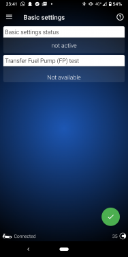

@TomsFocus here's OBDEleven with its fuel pump prime function, it starts whining but I didn't let it run too long as I obviously don't need to prime my filter! Although it says not available, the green button toggles it. If you're nearby don't mind popping over if you want to do it this way.
Thanks for the offer, Ted...I'm 200 miles away though if your location on here is still correct! :laugh:  What do you use for that btw?  Carista dongle?  I've been after something to use with the VAGDPF app as I currently have all diags on laptop which can be a pain.  I must admit, the cheap VCDS has been invaluable so far though, only bought it to activate cruise on the A3 last year, but since then it's done plenty of fault reads and added things like auto-locking on the Golf.  Plus swapping an entire gateway module & adding cruise on a neighbours Mk5...which I was a bit worried about lol!
Made an interesting discovery yesterday though...I couldn't hear the fuel pump prime at all...  :unsure:  First time I got in and immediately realised I always have the fans and stereo come on with ignition so wouldn't have heard it normally.  But switched those off when I parked...came back an hour later, switched the ignition on, and still no pump whine!  😮  Either it's very well soundproofed, or it holds enough pressure not to need priming until it's cranked.  Either way, I'll try VCDS on it as that seems to be the generally approved way.  As said earlier, I'll need to use VCDS to reset the longlife service interval as well (can only reset standard time & distance through dash) so I'll need to take the laptop out anyway.
