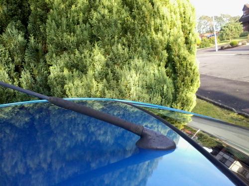

Since getting my car less than a year ago, I noticed that the FM reception wasn't great, station dropped out often, but grew to live with it. However, on having a loan car last week (a very basic Hyundai) it grabbed reception everywhere I drove. I've read that the connection between the aerial and the roof mount can corrode so I thought I'd simply unscrew it and clean, however, it simply won't budge. I priced a replacement from Ford and they no longer offer the original separate mount, and rod, you need to buy the mount complete with coax cable loom, and separate rod (which will not fit original mount!). Cost is £46 all in, which isn't big money, but, do you think it'll cure it?
You can see from the photo that time has taken it's toll on the rod & mount with both showing signs of rubber degradation...

I cannot unscrew the rod. I have even tried a pair of mole grips cushioned by cloth and couldn't get it to budge though it did strip off some surface rubber. I don't need a signal booster as I'm convinced  if the aerial just worked, the signal where I drive is plenty strong enough.Yes, you can pick up replacement rods on Ebay for less than a tenner, but they are nowhere near the same length as the original Ford rod at 58cm. I like 'original'. But useless anyway as I can't get original off, and further force I feel would only break the original roof mount.
ignore the antenna rod its nothing to do with the fault

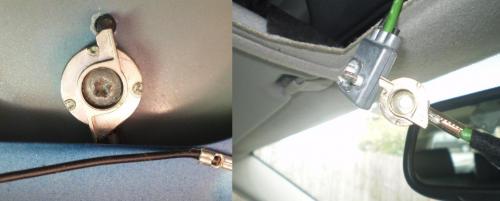

the bolt MUST not short the antenna rod and roof housing to the earth shield ….but the clearance is too little so easily can.  mine left the factory shorted out and you can only get very powerful local stations reliably
its quite clear in the picture you remove a small amount off the edge. the tapered bit is what holds it to the car pressing against a plastic shroud inside the antenna wire housing / shield.  it does up just as tight but cant short anymore killing the Ariel
pic here, the two look like there are supposed to touch (housing and bolt) but they shouldn't.... there is plastic between the two at the point that does the work (securing the Ariel to the car) but the edge of the bolt head shorts and kills it anyway

looks OK to me, [edit, ok zoomed in its a bit fu**ed] and you can see the bolt too close to antenna shield (hence your issue with signal strength)

On getting a photo of the actual aerial connector online, I'm a bit confused. It looks as if it's all metal construction is designed to make a metal to metal contact with the mounting bolt? If it needed insulated in any way, wouldn't there be some kind of rubber grommet or something similar? Am I just overthinking this? LOL
how clear do I need to make it
if the bolt touches the shield the Ariel stops working
between the bolt head and the car is SHOULD BE a plastic shroud (inside out of sight in the antenna housing on end of the wire) this stops the coax of the antenna wire touching the antenna rod on the roof killing it dead, as we can clearly see on your car the bolt and the shield are touching hence the antenna doesn't work (and or some ***** who messed the bolt head may well have messed up the housing / removing the plastic bit (that MUST be there), the plastic bit is clear and hard to see but a critical element
you are right its a T25 I just checked, I be shocked if the right tool couldn't get it undone... is your tool square at the end or round off, as two worn elements won't work

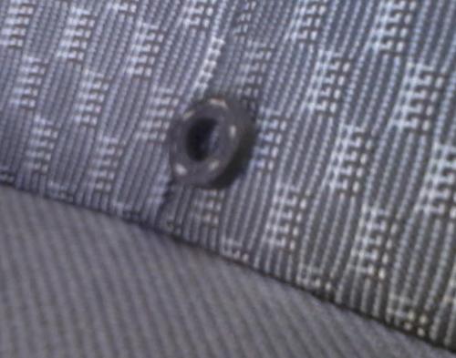

He then cut a custom washer (to ensure the bolt was correctly insulated from the aerial shield). This was cut from a length of fuel hose!

New insulating washer...

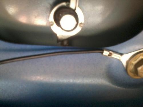

the original bit on early cars was a T25 torx headed bolt with a taper and a tapered washer.... below is the genuine bit with the edge ground off

Hey buddy, I'm not blaming anybody LOL Just annoyed at myself for not looking at it properly and deciding myself what kind of tool I needed for removal. Everywhere I looked online it was quoted as a T25, so in my head, before even looking at it, that's the tool I needed. Anyway, I've had another drive in her and reception does seem to have improved, so all good...

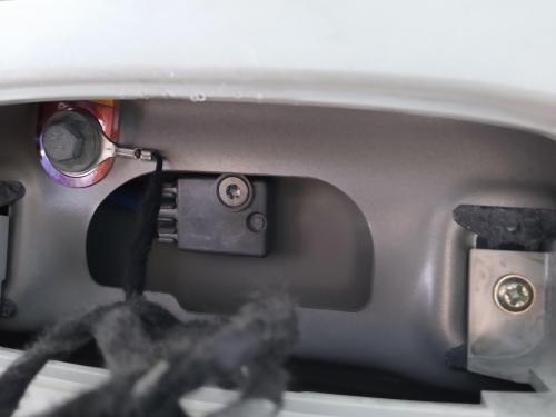

I had a go at mine this weekend in between the rain.  It was definitely a T25 Torx head on mine and came out easily enough.  I made up a rubber gasket using old bicycle inner tube but that made the bolt too short to reach the aerial base so I had to root around to find a longer M5 bolt.  That one was too long so added some washers to get it to tighten.  The old one looks like it had blue loctite on it to stop it coming undone so hopefully the aerial doesn't fly off now.  Photos of the old nut head and with the gasket added, but before i switched to the longer bolt so others can visualise it.  Big thanks to Botus if this works after years of putting up with crap radio reception!
