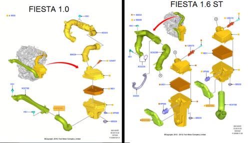

On 11/16/2019 at 6:34 AM, Tekno said:
Oh and a 1.6 engine is four pot and the 1.0 ecobost is three the intake system is different
The lower airbox and filter are identical. Hence the Mountune replacement being interchangeable between the 2 models 🤔. If the filter passes enough air for the 1.6, it will certainly be adequate for the 1.0. Hence my point of a CAI being a waste of money in this case.
I had the idea from references such as below (from "Car"magazine), that it was the Mountune and ST200 boxes that were similar/interchangeable, not the 1.0 and 1.6?
"This brings the ST200’s actual potency up to the same level as the Fiesta ST Mountune tuning kit.
That too sounds somewhat fishy…
Indeed. You probably won’t be surprised to learn that Ford and Mountune worked very closely together when developing the original Mountune kit – to such an extent in fact that, according to the ST200’s programme chief, the intellectual property rights remained with Ford. This allowed it to easily implement a similar strategy of intake mods and software jiggery-pokery in this instance.
Mountune remains Ford’s officially endorsed partner, however, so don’t think there’s been a falling out."
2 hours ago, Tekno said:
Well done, youve got the mk8 1.0l intake and the mk7 ST intake. The 1.6 and 1.0 mk7 airbox bottom part, snorkel and filter are thesame, both cars can use the Mountune metal box or the ST200 box.
