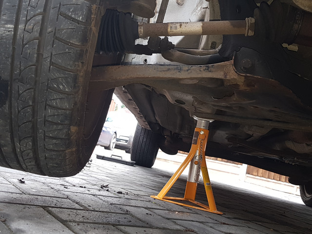

Bought it as an insurance write off (CAT N) and it wants a new front bumper, front  offside wing and wing mirror. All the damage looks to be superficial bar the suspension damage.
I'm at a loss at the moment and usually consider myself to have a good amount of knowledge when it comes to car mechanics.
It looks like it has either hit a kerb or brushed up against a bollard which has bent the front O/S wheel in. So when the steering wheel is straight the offside wheel points inwards.
I've removed and examined the front wishbone, steering knuckle and shock and they look okay. Haven't removed the tie rod but this looks straight and it would have been pushed out and not in when the accident happened.
Had a quick measure up of the subframe and compared it to a straight car and the measurements are fine. Obviously something isn't quite right here but can't work out what it is.
Wondering if any eagle eyed Ford enthusiasts can spot anything that I've missed.
My next plan is to replace the entire front end, subframe, steering rack, steering knuckle, front shocks. The parts for all of this will likely cost around £100 but wanted to try and avoid doing that if at all possible and only buy what I need.
For anyone else that experiences a similar issue - it was either the front steering knuckle or shock which were very slightly bent, couldn't tell by eye. Replacing the entire leg seems to have fixed my issue.
