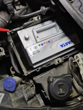

Hello everyone, bit of a random one I'll admit, my cars been playing up lately so used the ebay 20% off code to pick up a battery from euros ebay store, checked the reg on their site first then found the same battery on ebay, it's a varta silver 075, it's arrived today but is way smaller physically than what's currently in the car and has lower power ratings too (the original is 70Ah & 650A vs 61Ah & 600A) so what's going on people or am I just too tired today 😂

It's about 40mm too small & the bracket doesn't hold it in place, I could put a piece of wood in the tray to stop it sliding but surely somethings wrong here 😂
Isn't there another bolt hole a few cm further in that you can use instead? There are normally different holes to allow for the various batteries that are used in that model's range.
Clearly you have bought the wrong size battery.You should be buying a battery with the correct dimensions.Generally the bigger the battery the higher the specification (CAA and AH rating)👍

No, which is strange cause that battery is what's recommended online and euro & cp4l both bring up 075 batteries off my reg.

I stupidly trusted euro & cp4l to find the right battery off my reg. Hopefully I can contact ebay and they'll let me return it to a store rather than have to post it back.
it's all a bit of hassle , is the height the same or does it not reach the bar that bolts down across the top?
If I was in your position and the height is right and the cables reach correctly I would probably shove a bit of wood down there, At the back end , not the front end.
i know it's not right but it's easier.
Should be using a type 096 or 100 battery in a Diesel Fiesta
I've taken the 075 back & I'm collecting a 100 tomorrow, the guy in euro was reluctant to "let me" order a 100 cause the system said 075 but it's a 100 in their & the dimensions match.
Probably a higher spec battery than the 075 as well👍
Yeah 72Ah & 720cca & 5 year warranty again (exide).
