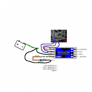

Hello,
I'm trying to fit an Omex rev limiter to my Fiesta(mk6 1.4l Duratec from 2003).
I'm having Problems im Pretty sure I wired everything correct but its not working.
To go into the Settings I Press both Buttons as in the Instructions(Both Leds flash up as they should to). But then you need to Press either + or - and then the Leds should light up.
The Problem is they don't so i can't change settings on the Rev Limiter. I laid an extra mass Cable into the Interior to Wire the Launch Control button and the Rev Limiter(Green in the Picture).
Maybe somebody can help me or has the Same Problem.
Thanks 🙂
