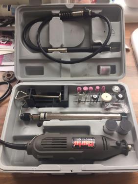

Spring broke on our car a while back, and the top nut was seized on solid, I've a Clarke mini hand grinder with flexi-pipe, fitted a tiny cutting disc and carefully cut the nut, was dead easy.
You can see the flexi-pipe in this picture, one of the best little tools I've ever had, it can get into most mega tight places.
I replaced both springs on the shocks with new nuts and then had the tracked checked, after that I covered the nuts in grease.
I purchased the Clarke tool to grind off a nut on the sons car, best £35 ever spent.
