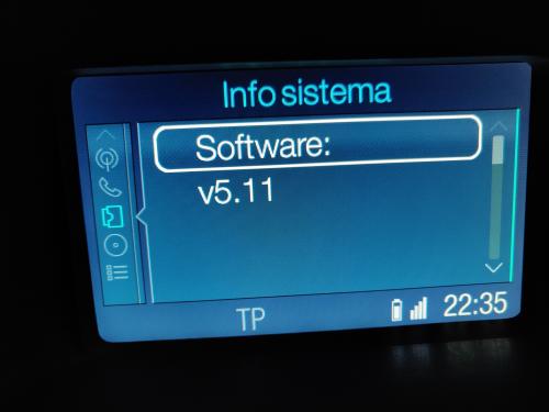

Hi there.
Can someone confirme i have SYNC 1.0 (not 1.1)
For SYNC 1.0, the last version is 5.9 ?
Where Can I found a link please ?
Cheers
Hello Stavros,
The sync you have as far as I can tell from the photos is version 1.1.
Sync 1.0 has a much “older” look to it...image.thumb.jpeg.e4a4e1837d4c0535c0f2f55d28f44402.jpeg

fgservo, could you tell me what apim number do you have ? Juste get up to the this menu, you should have EB1T or D1BT.
Mine is AM5T.
Many thanks
Yes, i see it now, you must have E1BT (Sync 1.1), and you have AM5T (Sync 1.0).
DB1T is (Sync 1.1), it will work to.
