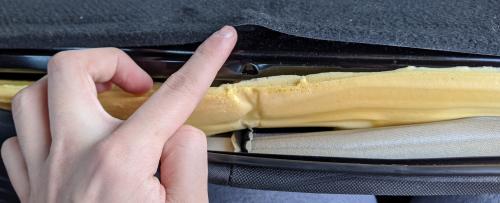

I've managed to get the front cover off of the seat, but i don't really know where to go from there.
The plastic holes where the headrest go in seem to stopping me from taking it off further and i don't really know how to remove them.
In the picture you can see how far I've gotten.
Anyone know where to go from here?

The headrest tubes come out by putting a flatblade screwdriver down the side of tube and press a tang on tube. Not easy to explain. Will see if I can find an image.
But more importantly, I got a feeling the seat back cover is glued on which covers the bolt. Try pulling the seat back cover slightly on a corner to see if is.
