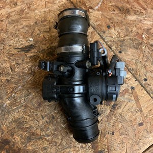

Most of those codes aren't for the EGR valve, they're for the air doser which works in conjuction with the EGR.  It's often called a diesel throttle body but that's not really an accurate name.
It's in the boost piping on the left hand side of the engine as you look at it and looks something like this:
Image result for focus 1.6 tdci air doser
