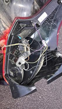

Ok sorry for the multi post, but to keep things simple. Here is the drivings side wiring in which you can see the old school halogen side is present:
as you can see, there is no loom to connect to the LED segment...
And on the passenger side, the led works, and is connected.  So although clearly something very odd is happening, where the hell is the loom for the drivers led - because it appears to be integral on the passenger side.  Again, here is the passenger side for comparison:
Which leaves me with this ridiculous situation.  I’m just surprised I didn’t notice sooner 😞
Edit: it’s the loom isn’t it.  The loom within the cluster from the big multi plug is wrong.  Any idea whether they can be purchased separately? Pretty sure I can just mimic the wiring if not and it’ll work but Car is still under warranty from the seller and with ford, but I suspect ford will say it’s been messed with.

When I said loom I meant within the cluster itself - it appears as first glance the LED 2 pin is just tapped in on serial with the halogen - not sure what turns the halogen off though.  It’s like they found an led cluster but used wiring from a non-led cluster or some other madness.
i believe the pink wire need cutting, and patching into the LED, and the net from that patched back in.  Really don’t want to get into this, but how do I explain this to the car supermarket monkeys or ford!
might be safer to do it myself...

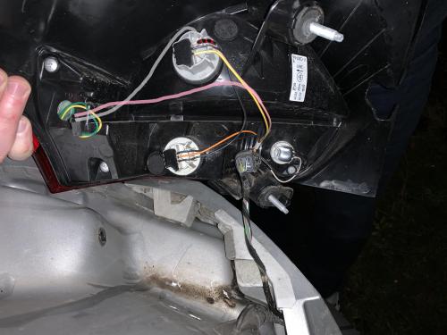

EDIT: Update, for the first time ever, the thing I wanted was on ebay for a reaonable price, at the right time.  I've bought a broken LED cluster for very cheap, so I'm just gonna take the wiring off it and put it in mine.  Considering I'd need to buy the right connector and grommit etc, this seems the best solution.
As attached, this would be my plan to fix it.  However, I'm not sure if this will mean both the LED and halogen will light up?

thanks!  oddly you have different colours, but ultimately it's as I thought, but I've hopefully got a donor cluster now too.  Thanks for everyones help!
Boom! All sorted.  The cluster is defo not genuine ford (compared with the genuine one I bought). Very happy with the solution though. Just need to sell the donor cluster now!
