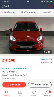

No idea how to grab a link from autotrader app but the below pic gives a good idea.
Looks like a standard projector with an led bulb for dipped beam

Yeah, I would say that's just someone having put either an LED or whiter halogen bulb in the standard projector housing.  I've done the same on mine, it's a fairly normal thing to do.
If cars have the factory fit LED headlights the low beam actually has two lenses illuminated within each housing, this makes it a little easier to identify.
If that's one in Acrington, yes I've found it.
That is a vey new one as it's a Trend with the 95ps Ecoboost engine, ours is only the 1.1 85ps.
They look much whiter than our headlights so it looks like they are now LED.

As it is advertised as a brand new car, I very much doubt it has been modded already!! It does look like the lights are changed for 2020.25 model year.

I'm wondering if it's just the camera as even the advert states halogens in projector housings with LED running lights?
Fair point, it also has manual headlight adjustment, I thought all LED lights had to be auto adjusting (even though lower powered Xenons don't) so who knows. Weird that the pricelist is a little ambiguous.
