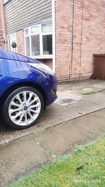

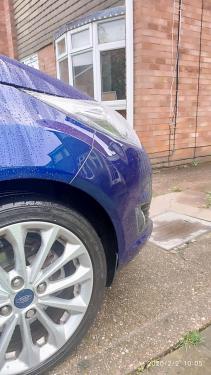

uploaded a couple of photos. i have tried to catch the reflections best i could. but the camera doesn't really show it up

It looks very good to me. The colour match is perfect and the finish is as good as I think you'll get given it's not the original factory paintwork. If you know where it is then you'll always be able to find it yourself.
the colour match is good just the reflections don't look good to me
That looks pretty good to me also, can't tell from the pics where it is. Perhaps the water beading helps - I was always told not to look at a potential purchase in the wet. Mind you, the reverse applies when you take it in for a trade-off valuation, aim to go when it's just rained!
I can see the difference, where the reflection of the white window is ? maybe getting some 2000 grade paper and wet flat th area and repolish up, not a hard job and 2000 grade paper won't take much lacquer off.

yes this is the location of the repair have attached a closeup and a second one of pin holes in the lacquer what would cause these and can they be removed.

Okay i agree its not a good job to be fair,i wouldn't be happy with that at all.Its not the worse but i would not be happy with that repair on my car my opinion.
Ah! Yes, I can see it from that angle, unfortunately - especially the left hand photo.
Is the fingerprint in the lacquer ? Looks a rushed job and the painter has applied heat to get the job done quicker.

I think it's the colour coat

That's a better photo. Now I can see it properly I agree with the previous couple of comments. That's not a good repair...…...unfortunately 😥

i will get in touch with them tomorrow i went with them as they offered a lifetime warranty and said it would look "as good as new" when done which this is not.
Went in today. As the defects are below the clear coat the only option is to strip back and complete the repair again so car is going back next week.
