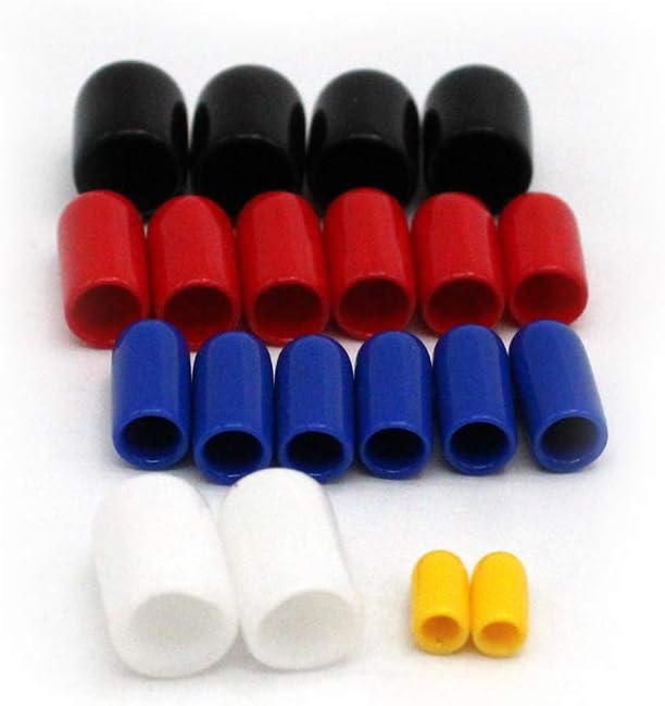

I do have these lying about that I could see if they fit the end of the brake line but not sure how useful they'll be.

There is no significant pressure in the brake lines (unless some drongo hits the brake pedal of course!), so a close fitting plastic cap would work ok. I tried insulating tape once (unplanned operation, done in a hurry!), that failed, I came back to find fluid dripping out onto the drive. Doing things in a hurry always takes longer, I find!
I found a solution and that was to buy some brake line fittings (they're cheap as chips) and I pushed a tap washer in one end of a coupler, which I then screwed onto the open brake pipe I'd unscrewed the brake hose from. Seals it a treat. If you're going to fit new pads and disk then you're going to have to retract the piston. Do  NOT do this without clamping the hose and opening the nipple first. What could happen is the seals in the master cylinder could flip and cause you a major headache. (I know, I was that soldier)  tdci-Peter beat me to it, but it really does happen. I ended up sourcing a replacement master cylinder,.. I found it impossible to replace the mc seals even tho' Bigg Red sell 'em.
