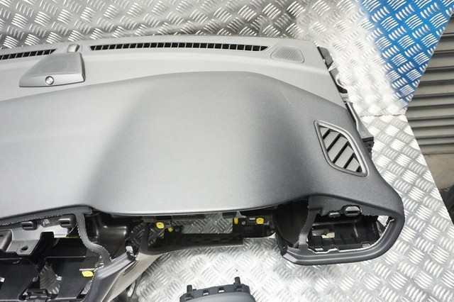

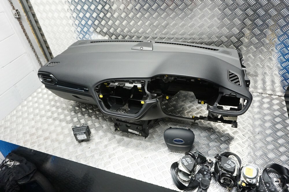

Hmm, do you have the B&O speaker on the dash?  It's hidden behind that if so.  It's more square than domed on the Mk8, can just about see it here.   (Click it for full res image, forum compression lol).

Nope the trapezoid covering is there, not sure what it is for but not the round item on it. It is the same on both, one is 18 and the other 69 plate St line X.
Edit....  I see what you are talking about now. Yes there is a squarer shaped dome at the front of this, nearer the windscreen. Got it.
