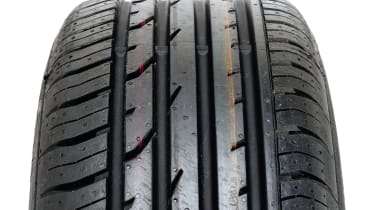

I have attached a couple of pictures of the tyres as tbf I was surprised they were flagged up on the mot as they look good to me

currently have continental premium contact 2 fitted generally a good summer tyre however not all the tread is to full depth this is apparently to give a new tyre better stability/ rigidity but as it wares and the shallow tread disappears poor weather performance does deteriorate and because of this i don't recommend below is tread at 8mm vs 3mm
 IMG_20201114_124605.thumb.jpg.18071b011a9ee16092113aec27c51d22.jpg Continental ContiPremiumContact 2
