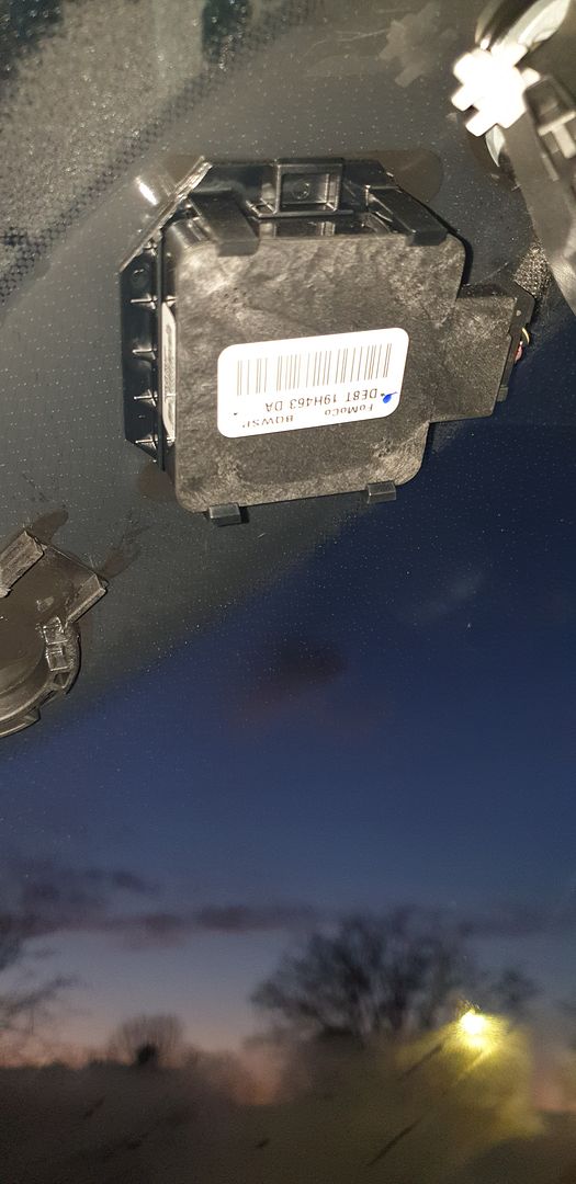

I have a 2015 Mk3.5 focus. Its only the zetec so no auto lights.
Removing the black surround I found this under there
No googling the number tells me its a rain sensor module. I have no actual sensor in place but I seem to have this module. I had found a document on that has the same module but this is listed as a gps module? My car doesn't have a sat nav for gps. So quite confused.
Is it as easy just to add a sensor and a switch and happy days? Will it also work with the auto wipers?
Any help would be great.
Many thanks

in the picture you share I can see the wires to the sensor, so why do you think its not there ???
are you sure you don't have A on the light switch already?  it might be as easy as fit an auto light switch and tick a box in the config on the gem..
In my case there were no wires. Bought used rain sensor and use this wires from aliexpress. Connect together with sensor and BCM, then use a Forscan to switch option:"with rain sensor". Works great.
