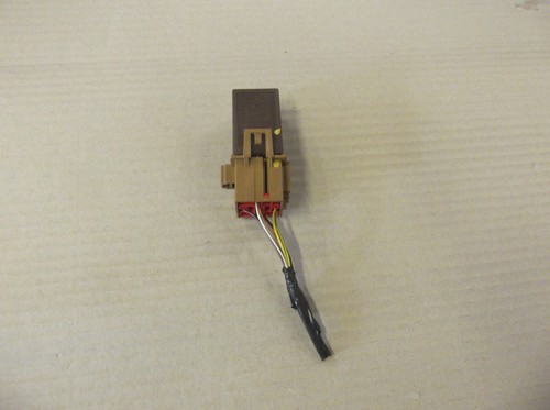

is it this?
A 2007 C-max can either be a late MK1 or an early MK1.5.
The C-max MK1 is electronically identical to the Focus MK2. On these vehicles the power fold mirrors are controlled conventionally by an additional module (Power Fold Mirror unit). This is basically a conventional relay module. The Focus/C-max module is extremely rare. Many people use the more common Mondeo MK3 power fold relay.
Note that the Focus MK2 / C-max MK1 power fold mirrors can only be folded manually by the switch. The mirrors do not autofold when locking/unlocking the car.
The C-max MK1.5 is electronically identical to the Focus MK2.5. On these vehicles the power fold mirrors are controlled digitally by the door modules. Power fold mirrors require the higher spec. door modules that support the power fold mirrors.
Note that the Focus MK2.5 / C-max MK1.5 power fold mirrors can both be folded manually by the switch or autofold when locking/unlocking the car.
thank you 🙂 my cars a pre facelift, however i've facelifted it.
but yeah the wiring is the older type
thanks for the help 🙂
