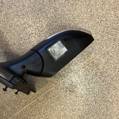

I've also experienced wind noise coming from driver window on my MK3 that I bought used. After one year trying to find the cause I finally found out what it was.
After checking both mirrors I noticed the passenger mirror has a little plastic piece coming out from the bottom near the door. The driver plastic piece was missing and there was a little hole where the plastic should be. I put some tape covering the hole and the wind noise is gone.
I'm not sure what's the function of that plastic piece.
In the image below you can see that very little piece of plastic at the bottom left of the mirror.
Outside temperature sensor.
The driver's side is just a blank isn't it? The sensor's in the passenger side (RHD) I thought.
Yes, that's right.  I'm not sure whether the blank is removable for the drivers side but it is definitely pressed into the plastic to some extent.  I'm also not sure whether they swapped the sensor for LHD models, as that seems unnecessary.
