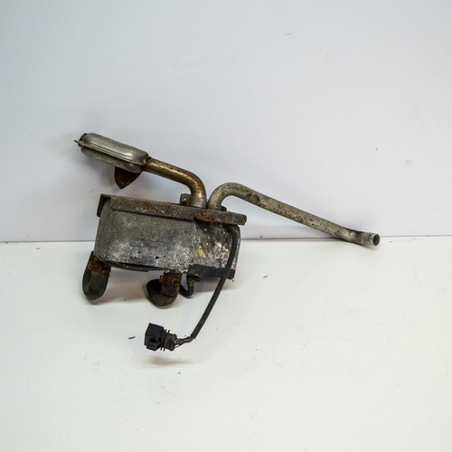

Hi guys
Not smoked until this am,i went under car with ,y mate and we think the electric connection is to the side of the dark box that the small exhaust so to say comes out of.
We cannot get the electric connection apart,we have tried and tried.
Any idea where is comes apart?
There seems to be sort of clips on the side but lost as to pull apart push together ha ha( tried both amd still wont budge.
Thanks again
Yeah, that is the right plug.  I can see it on some of the eBay ones, but I can't tell whether it's a push or pull clip.
I have had another idea.  Check the fuse list in the handbook.  If there's only one fuse covering the aux heater then you can pull that out instead of unplugging the heater.  Double check that nothing else is covered by the same fuse first though.

Time for me to jump in. The white smoke will be due to the glow plug on the fuel fired heater is no longer working orhot enough or at all to burn the diesel being sprayed in. I've replaced a few of those ( a long time ago) as already said, the heater only kicks in under a certain outside temp and coolant temp. Un plugging won't do any harm . The connector is a fiddle to un plug. Need a small screwdriver under the plastic bar and lever gently. Or a right angled pick slide down the side of connector. Difficult to explain. It's typical VW connectors. Or easier to pull the fuse.
