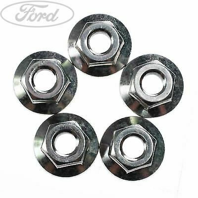

And two flanged nuts that look like this.  (Again, can't find correct ones available new)
Genuine Ford Nut - Flanged x5 4007285 - Picture 1 of 1
I had the 16v with no cover in an early 2010 Titanium, so I doubt the Sport Van of similar vintage had one either.
