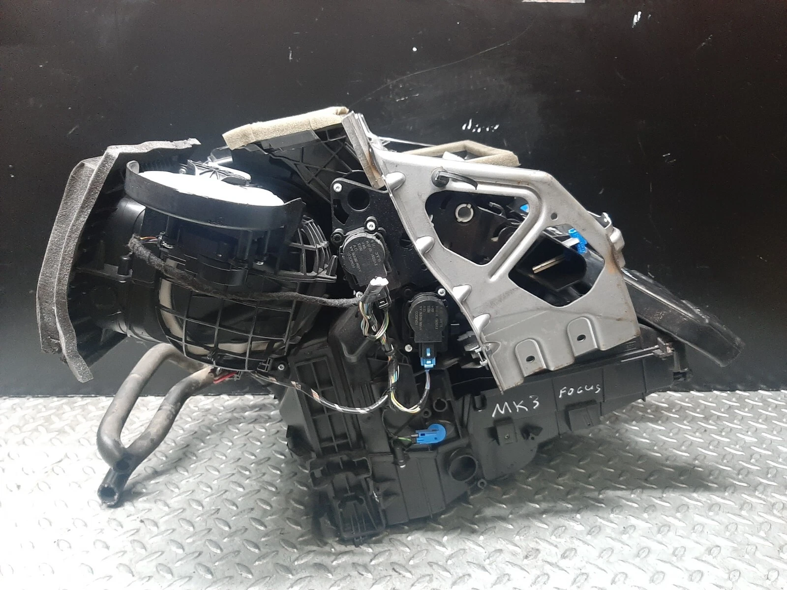

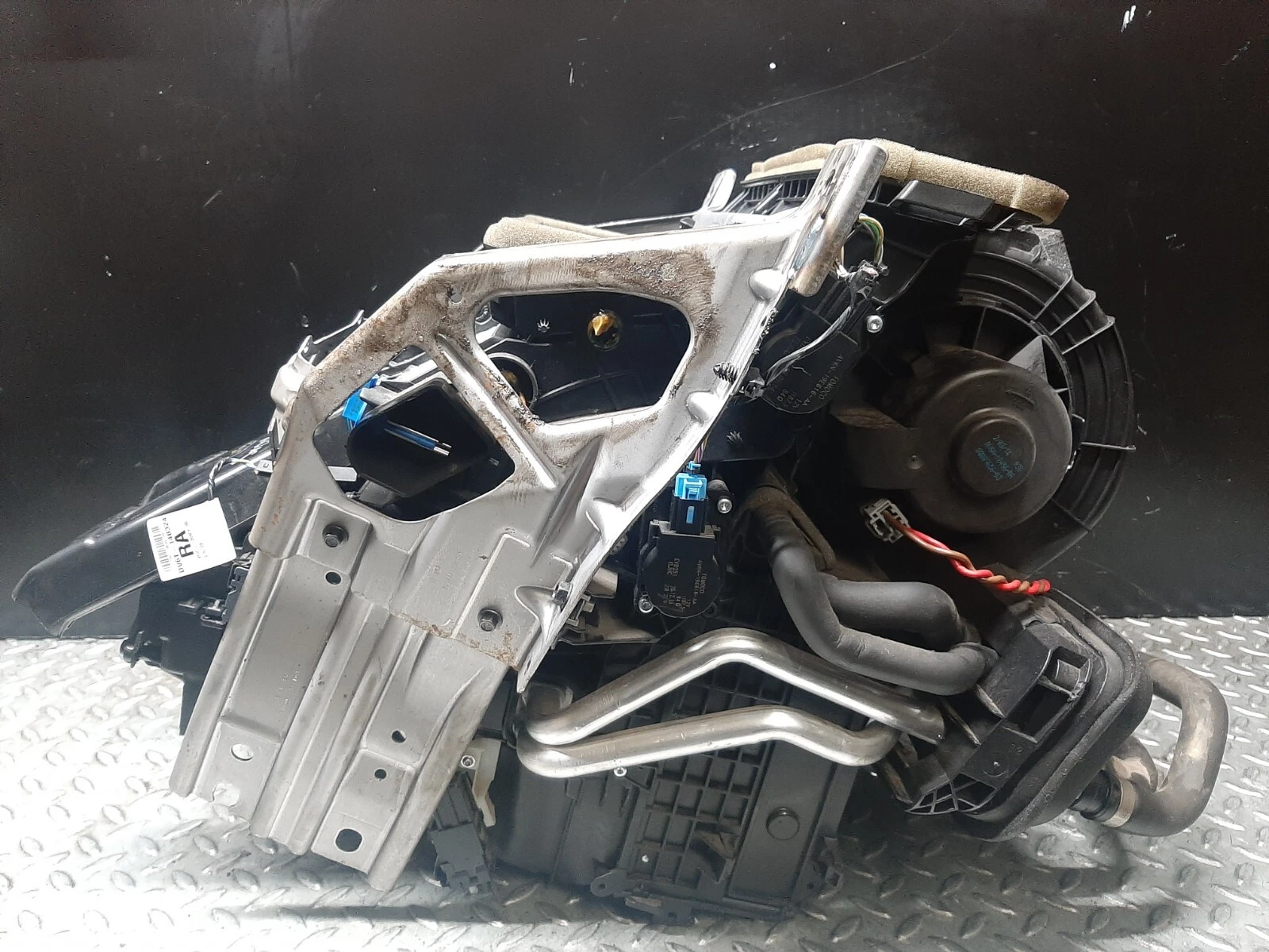

There are 4 different doors (flaps) on the dual zone climate, each with their own actuator.  Fortunately the actuators are all the same.   Part number 1786200.  They're literally just screwed to the side of the box.  Unscrew the old one, screw in the new one.  Plenty on ebay from just £10.  1786200 for sale | eBay
Some are for temperature blend.  Others are for direction.  I suspect it's the lower ones that are for temp as they have blue plugs - the other things with blue tops are temperature sensors, so that would make logical sense at least.
Passengers side -
FORD FOCUS MK3 2011 - 2017 DIGITAL CLIMATE CONTROL COMPLETE HEATER MATRIX BOX - Picture 3 of 7
Drivers side -
FORD FOCUS MK3 2011 - 2017 DIGITAL CLIMATE CONTROL COMPLETE HEATER MATRIX BOX - Picture 4 of 7
Thank you @TomsFocus. Any idea how difficult they are to locate? Do you know of a video showing how to get to it? Really appreciate your help 🙂
Did the pictures load in the post above?  That large box takes up the whole middle of the car behind the radio etc.  If you get your head in the drivers footwell and look up then you should see those silver pipes to help locate the blue plug of the actuator above them.
