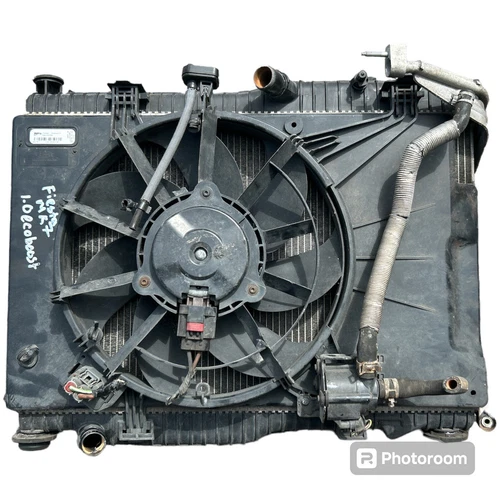

After further thought, I don't think there will be a fan module on that car.  Just a basic resistor at the bottom corner of the cowling.
You can unplug both plugs to see if they are damp or corroded inside.  One directly on the fan motor.  And the other on the resistor just outside of the fan itself.  The plugs may have a small tab or button that needs to be pushed or pulled to release them.

The cowling is just the large rectangular plastic sheet that the fan is mounted on.
This is one from a 1.0 EcoBoost, showing the resistor plug on the bottom left hand corner and fan plug right in the middle.

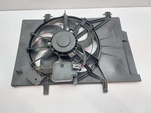

And this is one from a diesel, showing the square fan module bottom centre instead of the basic resistor shown above.
