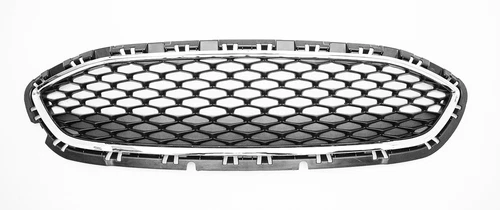

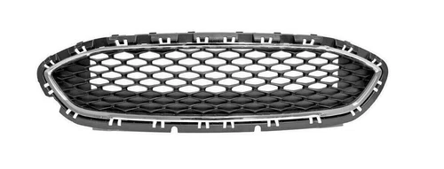

Ebay link below to it for reference
https://www.ebay.co.uk/itm/265197153595?mkcid=16&mkevt=1&mkrid=711-127632-2357-0&ssspo=n92ZltjHS0i&sssrc=4429486&ssuid=XcejRB_0Tqe&var=&widget_ver=artemis&media=COPY
Strangely, many of these are listed specifically for either petrol or diesel.  I wonder if the radiator is different on diesels so the grill needs to compensate for it.  The pictures do seem to show some with solid sides, whereas others are only solid along the bottom. 🤔
Fits Ford Fiesta Mk8 2017-2021 Front Main Grille Honeycomb W/Chrome Frame Diesel - Picture 2 of 8
For Ford Fiesta 2017-2022 Front Grille BlackChrome (Petrol Models) 2091018 - Picture 1 of 3
That would be a possibility I guess. Lots of hidden traps in these things, e.g.the ST-Line and ST front bumpers look identical but apparently they're not, to accommodate different intercoolers.
Tbh I thought we were talking OEM grilles here, but the part linked seems to be aftermarket and seems to require painting according to the listing.
