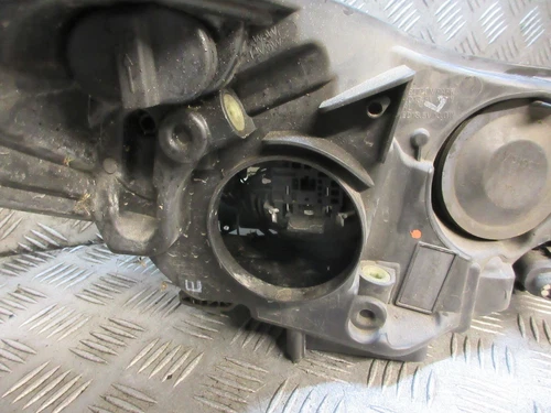

There is another rubber cover for the sidelight on Mk3.  Top left here with the arrow on it.
2011 FORD FOCUS MK3 Titanium 5DR PASSENGER FRONT HEADLIGHT BM51-13W030-DH - Picture 4 of 4
Yes that's the one and it's quite far in. If I drop it I've had it and i'll be fishing it out by the wires. Assumed it would be easier to take the entire backing off the cluster
It's not possible to remove the backing.
