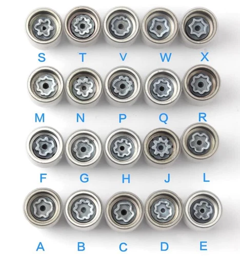

i see things like this on ebay such as pattern W which looks the same, would this be the case?
Anti-Theft Wheel Locking Key Wheel Rim Lug Nut Master Removal Kit Tools For Audi - Picture 1 of 7
Cheers
Does look like W pattern, hopefully with the right key the nut will stand up long enough for you to loosen it off.

Found it hard to get anyone online or ebay to match it.

Anyway, there are proper locking wheel nut removal tools which I would prefer for this job over the generic nut removers.  Those ones may just chew up the bolt head and cause a bigger problem, especially if the nuts were gunned up tight at a garage last time.
