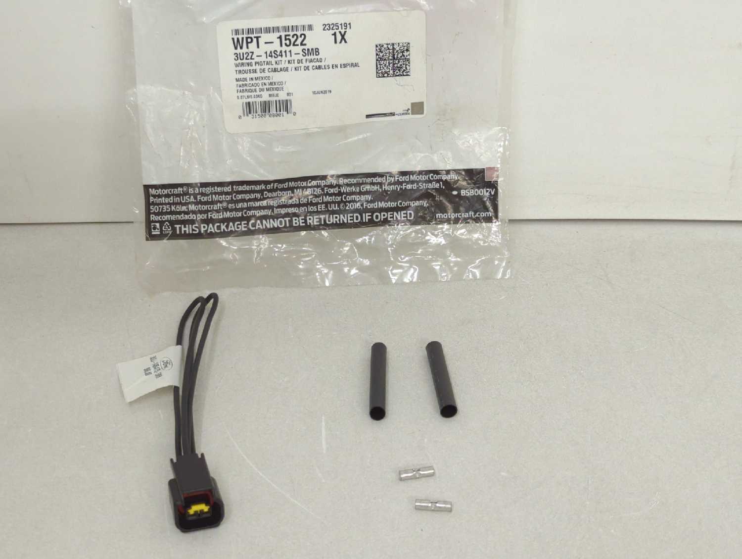

Only a few Years ago Ford started offering wiring harness repair kits. These repair kits consist of an assembly of the connector housing, connector pins and approximately 20 cm of wiring.
* Just an example of a genuine Ford (Motorcraft) wiring jharness repair kit.
Disadvantages are that these wiring harness repair kits are way overpriced (between €25,- and €50,- for a 2-pin repair kit is not uncommon) and only the most common connector types are covered.
Before Ford started offering these wiring harness repair kits they only offered complete wiring harnesses.
