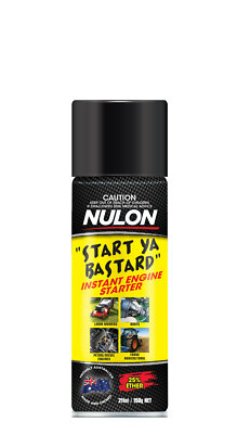

Hopefully they meant brake cleaner.  But given the title, it could also be this:
NUL-SYB150 NULON Start Ya Bastard Instant Engine Starter ,150gm Engine  Starter, | eBay
There's also (which should flag up timing errors?):
Ah, the Australian version of Easy Start!
