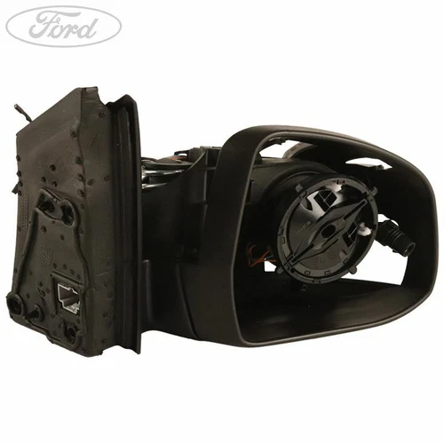

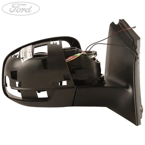

All of the wires come from the same loom at the back left.  It looks like that mirror base was a non-heated version as they should be easy to see unless they're curled up behind the motor.
The moulding shape of the genuine motor is slightly different.  Though I'm not sure whether that's enough to prevent genuine glass fitting or not.  The mirror glass has clips that should snap in around the back of the plastic ring.  On your motor it looks like there's a rubber seal tight at the back of the ring?  That could prevent the glass pushing on far enough though it's hard to tell from the photo.
Genuine Ford Focus Mk3 O/S Door Mirror Housing Dual Power HTD Signal 17- 2171867 | eBay
Genuine Ford Focus Mk3 O/S Door Mirror Housing Dual Power HTD Signal 17- 2171867 - Picture 1 of 4
Genuine Ford Focus Mk3 O/S Door Mirror Housing Dual Power Blind Spot 2171873 - Picture 4 of 4
