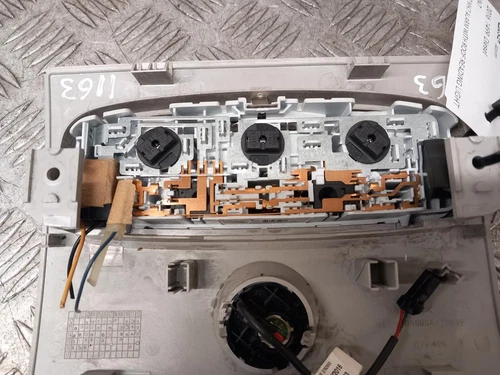

I fixed this by removing the dome light in my UK car, feeling back into the headliner and removing the RF receiver. There is very little info on this on the internet, so I hope this helps somebody else.
I scraped the pins clean with a flat head screwdriver in case they were corroded, and plugged back in, and now it's all working again!
I did find while I had this open, that there was also a burnt out blue wire that was jammed in to where the light screws in, and not plugged in to anything. This could relate to another issue I have with my heated screen not working.
Anyone know what it is meant for?
The single blue wire with a plastic plug?  It goes to the interior light.  Maybe the door open signal wire?  Definitely nothing to do with the heated windscreen.
Ford Fiesta Mk7 Alarm With Roof Reading Light 4M51A045B54DBW 2013 14 15 16 17 - Picture 10 of 12

@TomsFocus Thanks, strange, yeah you're right it deffo seems it should be for the dome light, but I couldn't see anywhere it would plug in. The light seems to work as it should too, but it's using after market bulbs. I think one of the past owners must have changed the bulbs, then pinched the wire up in to the metal bracket when pushing it back in, I think because it was touching the chassis it blew the fuse and burnt the wire out. A headliner wiring loom doesn't seem to expensive anyway from ebay.
