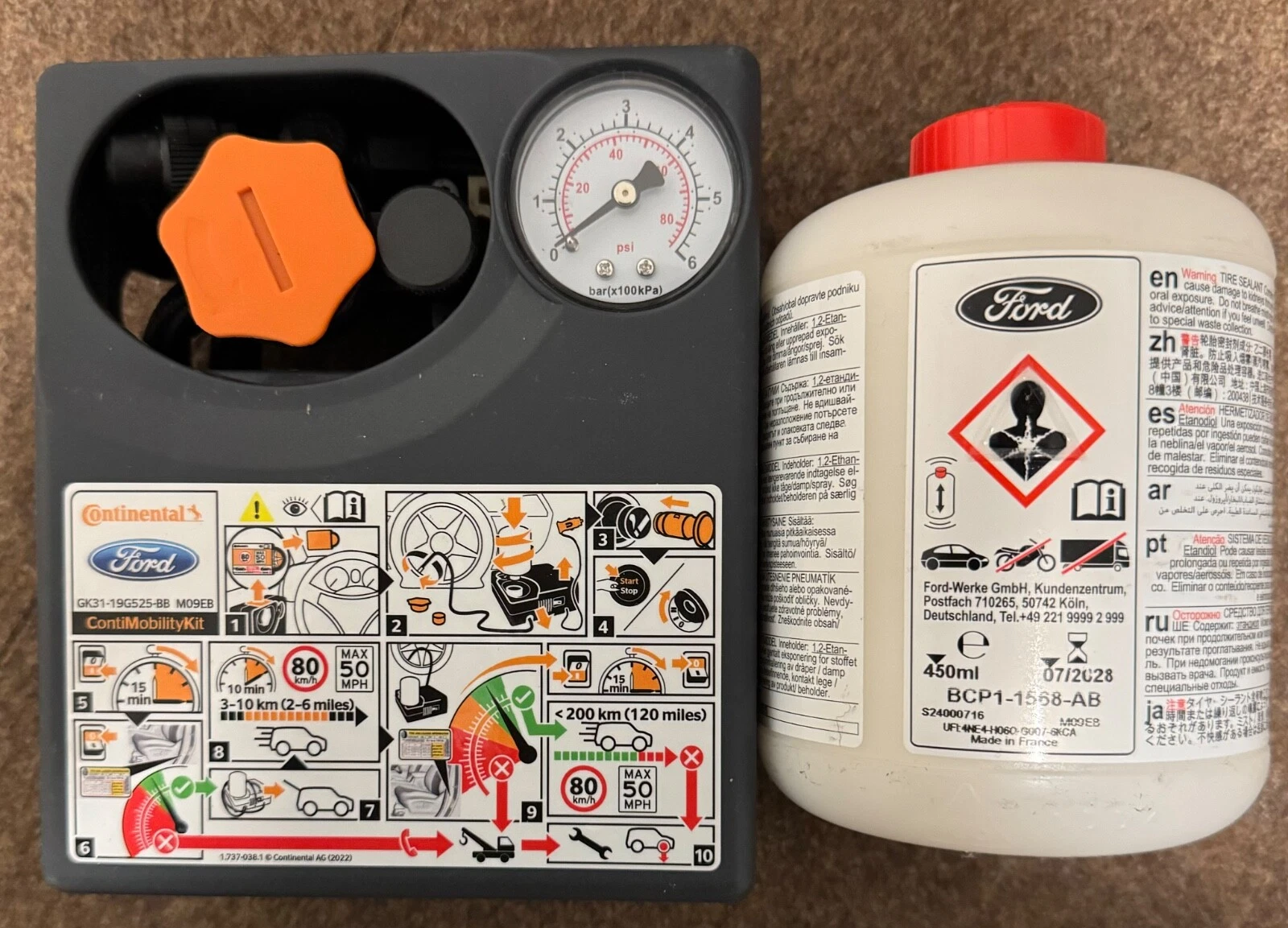

Whether the compressor can be re-used fully depends on the design.
Many ford models are fitted with a Continental emergency kit that has a tyre sealant bottle that is directly screwed into the air inlet of the compressor. Once the orange plug is removed the bottle can be screwed into place.
On this design the tyre sealant is drawn into the intake of the compressor and pushed into the tyre through the hose. The complete compressor, pressure gauge and hose assembly will be contaminated with the tyre sealant as a result.
This type of compressor is designed for single use. Once the tyre sealant solidifies the compressor must be considered useless.
Wonderful clarity in that instruction label.  Just what you need in a stressful emergency situation! :laugh:
It is possible to buy a new hose assembly for the Continental emergency kit. The only part that should get contaminated with gunk is from the orange cap to the end of the hose.

Thanks for all the feedback on this topic everyone! The repair kit in my Ford is the ConitMobilityKit, on the continental website it does show that the hose is designed to be replaceable so the whole compressor unit shouldnt be a single use item!
The hose I have has sealed up as a result of the sealant put through it, so at minimum the hose needs replacing
Seems replacing the hose recommended and a new sealant bottle appears to not be more expensive than buying a whole new kit
Thanks!

Says on the compressor. Max 120 miles at 50mph. Tyre should be checked and repaired or replaced as soon as possible.
Replace the tyre as soon as possible. The sealant is only intended to bring you home.
Cleaning up the sealant mess can be a challenge and is usually time consuming. Very few tyre fitters will actually repair a tyre properly after sealant has been used.
If the car has TPMS sensors, the TPMS valve and sensor should also be replaced after sealant has been used.
